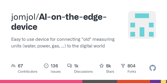

本文軟體參考文獻 : GitHub - jomjol/AI-on-the-edge-device: Easy to use device for connecting "old" measuring units (water, power, gas, ...) to the digital world
